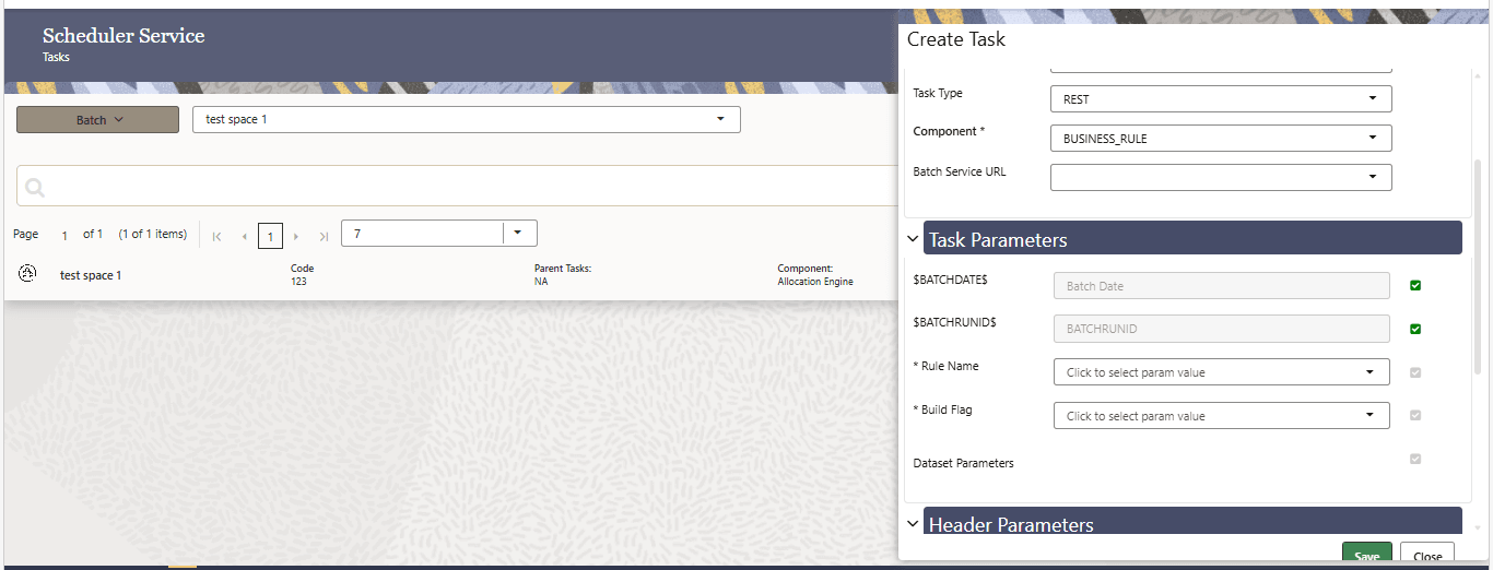

  5. Click + to create a new task.
  6. In the Create Task screen, enter the following values:
    1. Task Code (Spaces are not allowed in the code section). b.
    2. Task Name.
    3. Select the task type as REST.
    4. Select the Component as BUSINESS_RULE..
    5. Click Save.
    When the BUSINESS_RULE. component is selected, the Batch Service URL field is not displayed and does not require configuration.
    Figure 4-80 Define Task
    Define Task
  7. In the Task Parameter section, enter the following values:
    1. Rule Name — Select the Business Rule that must be executed.
    2. Build Flag — Select whether the Business Rule must be built or compiled before execution.
    3. Dataset Parameters — Enter or review the dataset-specific parameters required to execute the selected Business Rule.
    Figure 4-81 Define Task
    Define Task
