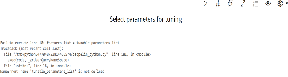

Select Parameters for Tuning
In this option, you need to select the parameters for which thresholds will be calculated. The default parameters are taken from the expression that the user must have set in the scenario execution notebook. The parameters are stored in the class variable asc.tunable_parameters_list.
Limitation
Figure 4-15 Error Message - Select Parameters for Tuning
%python-pgx
tunable_parameters_list = asc.tunable_parameters_list

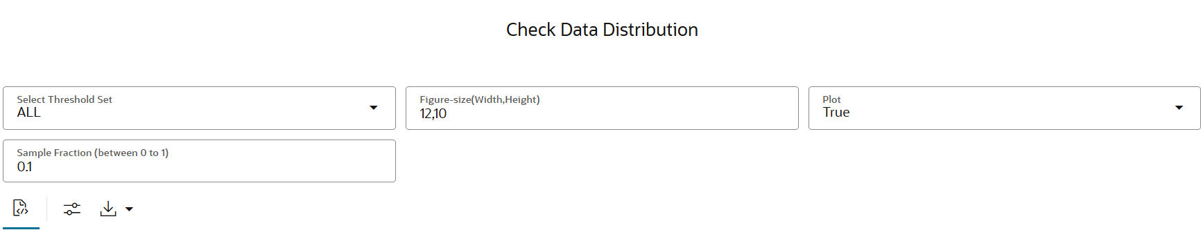

Check Data Distribution
You can see the data distribution for selected threshold set id and parameters and decide on the outlier techniques for calculating the thresholds to use.

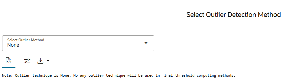

Select Outlier Detection Method
You are provided with out-of-box univariate outlier methods. The outlier methods are divided into two groups based on the type of population. For each of the method, you can select the tail either RIGHT, LEFT or BOTH for removing outliers.
- zscore: Outliers are number of standard deviations away
from the mean.
- Parameter nstdev. Default is 3.
- IQR: Inter-Quantile-Range (Q75-Q25). Outliers are
considered which is away from Q75 + IQR*iqr_cut_off.
- Parameter iqr_cut_off. Default is 3.
- percent_outliers: Percent of data points are considered
to be outliers.
- Parameter outliers_proportion. Default is 5%.
- robust_zscore: It is similar to Z-score method with some
changes in parameters.
- Since mean and standard deviations are heavily influenced by outliers, instead of them it uses median and absolute deviation from median.
- Also called Median Absolute Deviation (MAD) method.
- adjusted_boxplot: It is similar to IQR method with some
- It customize the range of valid data for both side of tails differently.
- Exponential model is used for fitting the data.
