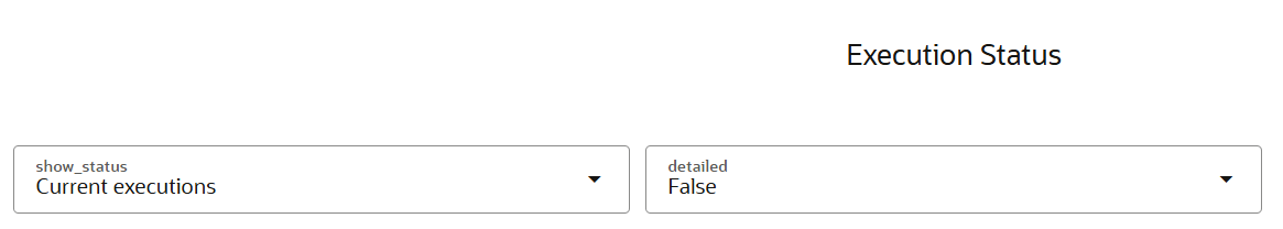

- Current Executions: It shows only executions which are currently running in the notebook python session.
- All Executions: It shows current executions along with executions from the previous runs/sessions for the same definition id and version.
Detailed Execution Status
Scenario having multiple Job Ids, each Job Id status must have COMPLETED, then only execution for given run date would be considered as COMPLETED. Otherwise, it will be marked as FAILED.Error log will display the error occurred in paragraph from the Utility Scenario notebook.

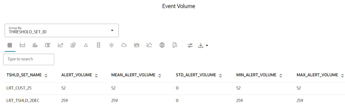

You can review the results of scenario execution. The summary of the event volumes is generated as shown below.
Event Volume
- RUN_DATE: Aggregate alerts by different run dates.
- EVENT_TAG: Aggregate alerts by event tag (ATL or BTL).
- RUN_DATE_AND_EVENT_TAG: Aggregate alerts by RUN DATE and EVENT TAG.
- JURISDICTION_AND_RUN_DATE: Aggregate alerts by JURISDICTION and RUN_DATE.
- RUN_DATE_AND_THRESHOLD_SET_ID: Aggregate alerts by RUN DATE and THRESHOLD SET ID.
- EVENT_TAG_AND_THRESHOLD_SET_ID: Aggregate alerts by EVENT_TAG and THRESHOLD SET ID.
- THRESHOLD_SET_ID: Aggregate alerts by THRESHOLD SET ID.
- ALL: Aggregate alerts by all inputs
together (by SEGMENT_ID, RUN_DATE, EVENT_TAG).
