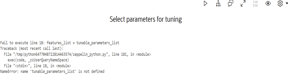

The Select Parameters for Tuning paragraph might fail due to a missing class object before the variable is used.
Figure 4-15 Error Message - Select Parameters for Tuning

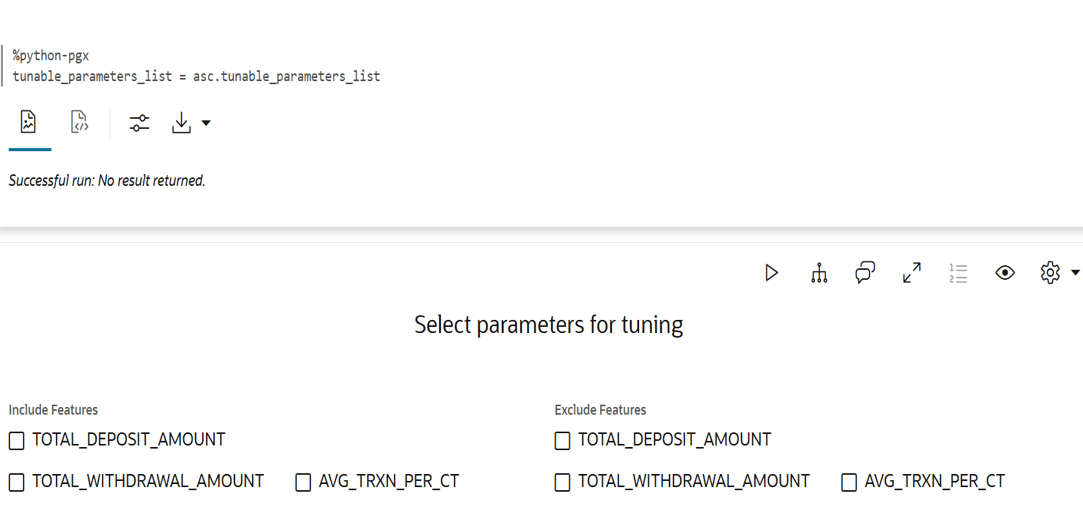

To resolve this issue, add another paragraph above the failed paragraph with the following and run the paragraph.
%python-pgx
tunable_parameters_list = asc.tunable_parameters_list
Figure 4-16 Select Parameters for Tuning

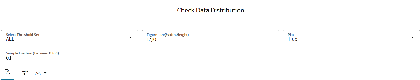

Check Data Distribution
You can see the data distribution for selected Threshold Set ID and parameters and decide on the outlier techniques for calculating the thresholds to use.
Parameter Sample Fraction can be used to take the subset of data. The Parameter Sample Fraction value is between 0 to 1.
Figure 4-17 Check Data Distribution

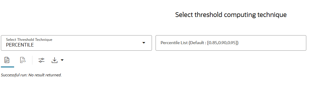

Select Threshold Computing Techniques
You are provided with following two out-of-boxes threshold computing techniques:
  • Percentile: Thresholds are calculated based on the percentiles.
  • Jump: Thresholds are calculated based on the highest peaks found within the range defined.
