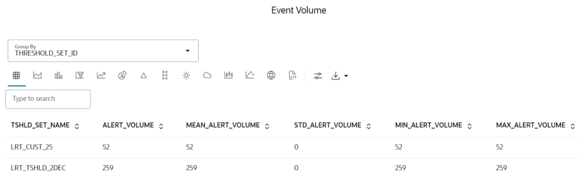

Review Results
You can review the results of scenario execution. The summary of the event volumes is generated as shown below.
Event Volume
- RUN_DATE: Aggregate alerts by different run dates.
- EVENT_TAG: Aggregate alerts by event tag (ATL or BTL).
- RUN_DATE_AND_EVENT_TAG: Aggregate alerts by RUN DATE and EVENT TAG.
- JURISDICTION_AND_RUN_DATE: Aggregate alerts by JURISDICTION and RUN_DATE.
- RUN_DATE_AND_THRESHOLD_SET_ID: Aggregate alerts by RUN DATE and THRESHOLD SET ID.
- EVENT_TAG_AND_THRESHOLD_SET_ID: Aggregate alerts by EVENT_TAG and THRESHOLD SET ID.
- THRESHOLD_SET_ID: Aggregate alerts by THRESHOLD SET ID.
- ALL: Aggregate alerts by all inputs
together (by SEGMENT_ID, RUN_DATE, EVENT_TAG).
