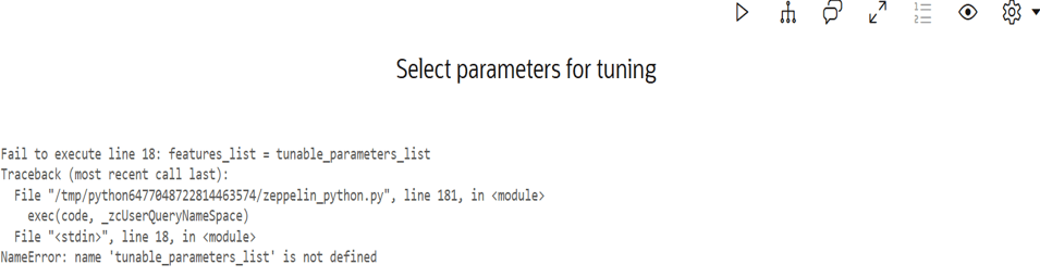

Limitation
The Select Parameters for Tuning paragraph might fail due to a missing class object before the variable is used.
Figure 4-15 Error Message - Select Parameters for Tuning

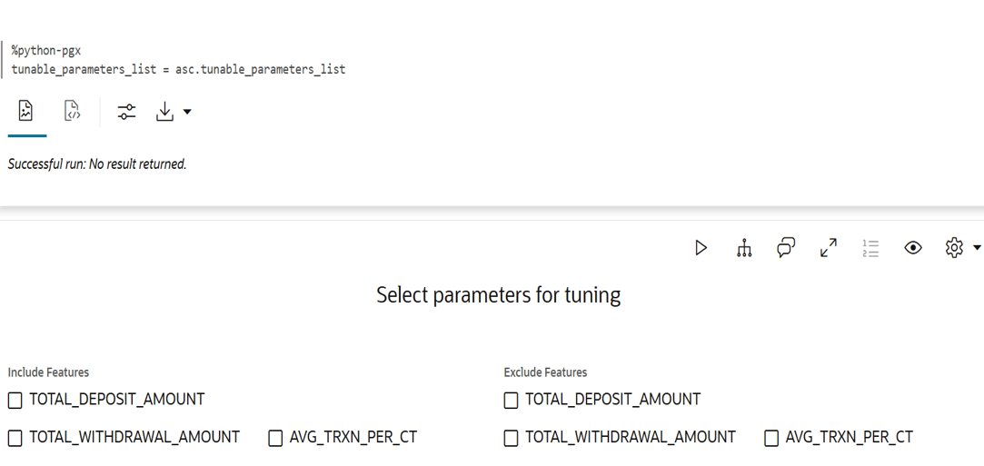

To resolve this issue, add another paragraph above the failed paragraph with the following and run the paragraph.
%python-pgx
tunable_parameters_list = asc.tunable_parameters_list
