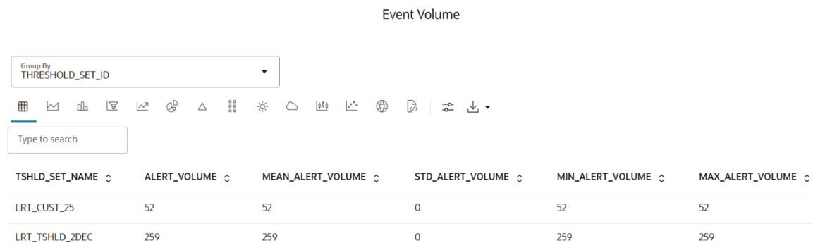

Review Results
You can review the results of scenario execution. The summary of the event volumes is generated as shown below.
Event Volume
You are provided with multiple groups options across run dates as follows:
  • RUN_DATE: Aggregate alerts by different run dates.
  • EVENT_TAG: Aggregate alerts by event tag (ATL or BTL).
  • RUN_DATE_AND_EVENT_TAG: Aggregate alerts by RUN DATE and EVENT TAG.
  • JURISDICTION_AND_RUN_DATE: Aggregate alerts by JURISDICTION and RUN_DATE.
  • RUN_DATE_AND_THRESHOLD_SET_ID: Aggregate alerts by RUN DATE and THRESHOLD SET ID.
  • EVENT_TAG_AND_THRESHOLD_SET_ID: Aggregate alerts by EVENT_TAG and THRESHOLD SET ID.
  • THRESHOLD_SET_ID: Aggregate alerts by THRESHOLD SET ID.
  • ALL: Aggregate alerts by all inputs together (by SEGMENT_ID, RUN_DATE, EVENT_TAG).
