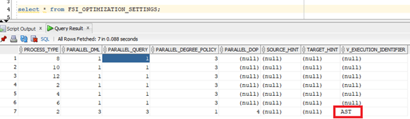

The data seeded into the FSI_OPTIMIZATION_SETTINGS table OOTB is shown in the following image.
There must be only one row of data for each PROCESS_TYPE and V_EXECUTION_IDENTIFIER combination. If there are more than one rows for a given combination, the engines refer to the row for which the rownum is returned as 1 for the given combination of values.

- The V_EXECUTION_IDENTIFIER column: This column is used to identify the
optimization settings to a specific branch within the PMF process. This can be
helpful in the following illustrated scenario.

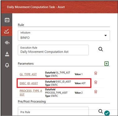

Scenario: When the volume distribution by the General Ledger types is such that the Assets contains a significantly higher volume when compared to the Revenue accounts. For performance reasons, the user may want to the process the journals specific to Assets at a parallelism degree of 16 v/s revenue accounts at a parallelism degree of 4. The value in this column helps the process to identify the row of optimization settings to be used for a specific branch. This column allows an input of type VARCHAR2 with a maximum length of 50 characters. This value is passed to the system from within the PMF process when you double-click the required Service Task. This illustration is shown in the following image (click the ).
- Navigate to the Process Modeller page and select the Balance Computation
Management Ledger process. In the Process Flow page, double-click any
Service task, then select .
Figure 14-1 Rule Implementation in the Service Task
In the preceding illustration, the EXEC_ID_ASST Value is AST, which is same as the V_EXECUTION_IDENTIFIER column (see the next illustration) of the FSI_OPTIMIZATION_SETTINGS table for a process.Figure 14-2 V_EXECUTION_IDENTIFIER column value in the FSI_OPTIMIZATION_SETTINGS table
Ensure that the Rule engine Execution Identifier Value (for example, AST) is same as the V_EXECUTION_IDENTIFIER column value in the FSI_OPTIMIZATION_SETTINGS table for a PMF process. - Navigate to the Process Modeller page and select the Balance Computation
