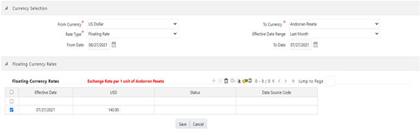

8.4.2 Adding Exchange Rate Data
After you have specified a value for To Currency, the Floating Currency Rates section appears. To define a Fixed Rate relationship, select the Fixed Rate Type and replace the Floating Currency Rates with the Fixed Currency Rates.
Figure 8-11 Defining a Currency Rate
The following list describes the columns in the Currency Rate window:
