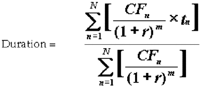

12.7.14.2 Cash Flow: Duration
The Duration method uses the Macaulay Duration Formula:
Figure 12-8 Cash Flow: Duration Formula
This illustration shows the formula to calculate the Cash Flow: Duration.
In this formula:
  • N: Total number of payments from Start Date until the earlier of repricing or maturity.
  • CFn: Cash flow (such as Regular Principal, Prepayments, and Interest) in period n.
  • r: Periodic Rate (Current Rate/Payments per year).
  • m: Remaining term to cash flow/Active Payment Frequency.
  • tn: Remaining term to cash flow n, expressed in years.
Oracle Funds Transfer Pricing derives the Macaulay duration based on the cash flows of an instrument as determined by the characteristics specified in the Instrument Table and using your specified prepayment rate, if applicable. The Duration Formula calculates a single term, that is, a point on the yield curve used to transfer price the instrument.
  • Within the Duration Calculation, the discount rate or current rate, r, is defined in one of three ways, based on how the methodology is set up by the user:
    • The current rate is defined as the Current Net Rate if the processing option, "Model with Gross Rates" is not selected and the Current Gross Rate if the option is selected. The current rate is used as a constant discount rate for each cash flow.
    • The user may directly input while defining the TP rule, a constant rate to use for discounts. If specified, this rate is used as a constant discount rate for each flow.
    • The user can select to discount the cash flows using spot rates from a selected interest rate curve. With this approach, a discount rate is read from the selected interest rate curve corresponding to the term of each cash flow.
