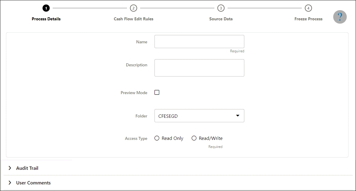

  1. Navigate to the Cash Flow Edits Summary page.
  2. Click Add . The Create Cash Flow Edits Process page is displayed.
    Figure 14-3 Cash Flow Edit Process
    Cash Flow Edit of CFE Processing
  3. Enter the process details shown in the following table.
    Table 14-3 List of process details used for Creating Cash Flow Edit Process
    Parameter Description
    Name Enter the name of the Cash Flow Edit rule.
    Description Enter the description of the Cash Flow Edit rule.
    Preview Mode Selecting this parameter allows you to view the results of running a Cash Flow Edit process before the system updates the underlying records in the Instrument tables. The default value of this parameter is checked.
    Folder Enter the Folder details where Cash Flow Edit rule needs to be saved.
    Access Type Select the Access Type as Read-Only or Read/Write.

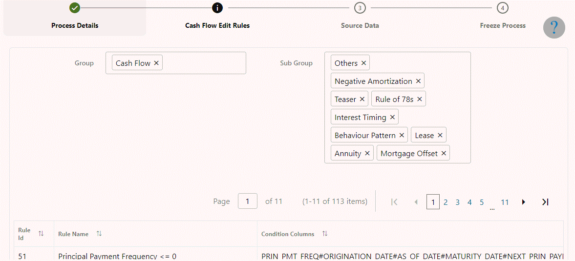

  4. Click Apply to navigate to Cash Flow Edit Rules section.
    Figure 14-4 Creating Cash Flow Edits Rule
  5. Enter the Cash Flow Edit details shown in the following table.
    Table 14-4 List of Cash Flow Edit details used for Creating Cash Flow Edit Process
    Group Select the group of Cash Flow Edit Rules that you want to include in the process. For example, Cash Flow
    Sub Group Select the sub group of Cash Flow Edit Rules that you want to include in the process. The value of this field varies based on the selected Group. The list of Rule Ids with conditions is displayed.
    Detail of rules for the selected group and sub-group are listed on the screen for reference.

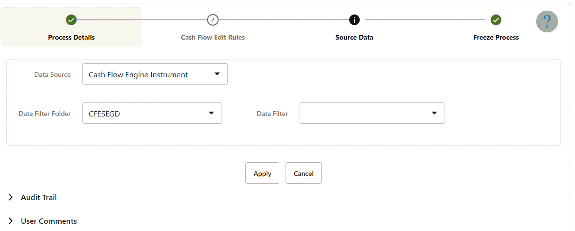

  6. Click Apply to navigate to the Source Data section.
    Figure 14-5 Creating Cash Flow Edits Rule
  7. Enter the Source Data details shown in the following table.
    Table 14-5 List of Source Data details used for Creating Cash Flow Edit Process
    Data Source This field allows you to select the Instrument tables that must be included in a Cash Flow Edit process.
    Data Filter Folder Select the Folder from which you want to apply Data Filter
    Data Filter This field allows you to select a subset of data for processing by selecting a filter that was previously created.
    To select FX Contracts instrument tables from the Data Source drop-down, do Setup Master Configurations. Insert the records into the setup master table as mentioned below:
    V_COMPONENT_CODE V_COMPONENT_DESC V_COMPONENT_VALUE Description
    CFE_EDITS_TABLE Cash Flow Engine Instrument FSI_D_CFE_INSTRUMENTS
    This is used to display source table name in Cash Flow Edits screen. V_COMPONENT_DESC contains logical name to be displayed in screen while V_COMPONENT_VALUE contains physical name of table in database. To add more than one table use "~" as separator.
    Example: V_COMPONENT_DESC can be "Cash Flow Engine Instrument~Custom Table" and V_COMPONENT_VALUE can be "FSI_D_CFE_INSTRUMENTS~FSI_D_CUSTOM_TABLE".
    CFE_EDITS_BATCH_SIZE Instrument Count to Process in Single batch 1000 This is to set Instrument Count to Process in Single batch
    CFE_EDITS_CALLABLES_SIZE Callables Count to Execute the Cash Flow Edits Process 8 This is to set Callables Count to Execute the Cash Flow Edits
    CFE_EDITS_FLUSH_BATCH_SIZE Save or Update Records Flush Batch Size 500 This is to set Flush Batch Size for Save or Update Records
  8. Click Apply to navigate to the Freeze Process section. Click Save on the Freeze Process window after verifying all the details.
