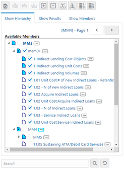

    Figure 8-5 Show Hierarchy Tab
    This illustration shows the Show Hierarchy tab, which displays the leaves in each node in ascending order of Members. You can expand the hierarchy to select the required value.
    The Show Hierarchy tab displays the leaves in each node in ascending order of Members.
    In order to sort the nodes alphabetically, HIERARCHY_IN_FILTER_SORT-$INFODOM$-$DIMENSION_ID$=$VALUE$ in the AMHMConfig.properties file present in the deployed location should be set as Y. You should add such entry for all the required Dimension IDs for the sort functionality to work for those dimensions.
    For example: HIERARCHY_IN_FILTER_SORT-OFSAAINFO-4345=Y
    Restart servers after making any change in AMHMConfig.properties file for the change to take effect.
    Select the Pagination icon to view more options under the available components. Click the More Options (three dots) icon to enable the Pagination buttons.
    From this pane, you can:
    • Click Search button to search for a hierarchy member using Dimension Member Alphanumeric Code, Dimension Member Numeric Code, Dimension Member Name, or Attribute and by keying in Matching Values in the Search dialog. The search results are also displayed in the ascending order of Member Names.
    • Click Collapse icon to collapse the members under a node.
    • Click Name Right or Name Left icons to view the name of members right or left.
    • Click Numbers Right or Numbers Left icons to view the Numeric code values of members right or left.
    • Click Show Member Code or Show Member Name icons to show code or show name of the members.
    • Click Focus or Defocus icons to focus or defocus a selected node except the root node.
      You can also click the Search button to find a member present in the nodes list using key words. For large tree (nodes>5000), this search will not return any value if the tree is not expanded.

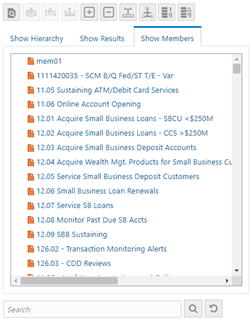

    Figure 8-6 Show Members Tab
    This illustration shows the Show Members tab, which displays a list of Members.
    The Show Members tab displays all the selected nodes in a list view, which helps you visualize all the selected nodes as a list rather than as a tree. Currently, this feature is available in the Edit and View mode of the Hierarchy Filter.
