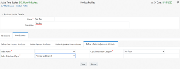

Figure 21-8 Inflation Adjustment Attributes Tab
This screen allows you to add the Inflation Adjustment Attributes to the Product Profile.
The Define Inflation Adjustment Attributes tab will be enabled if the Adjustment type is selected as Conventional Adjust, Conventional Fixed, Level principal, or Non-Amortizing.
Figure 21-9 Define Inflation Adjustment Attributes Tab
Table 21-10 Tabs, Fields, and Behavior of Inflation Adjustment Attributes
Tab Field Behavior
Index Adjustment Attributes Index Name Lists all Economic Indicator defined through the user interface.
Index Adjustment Attributes Capital Protection Category
Determines Capital protection to be provided to Inflation-indexed instruments. The choices are:
  • No Floor: No Floor does not provide any downside protection.
  • The floor of 1: Floor of 1 protects downside movement.
  • Max during Life: Max during life gives maximum advantage using maximum Index factor for calculation.
Index Adjustment Attributes Index Adjustment Type
Determines the type of Index adjustment. The choices are following:
  • Principal and Interest
  • Principal Only
  • Interest Only
For more information on cash flow calculations associated with Inflation-indexed instruments, see Oracle Financial Services Cash Flow Engine Reference Guide.
