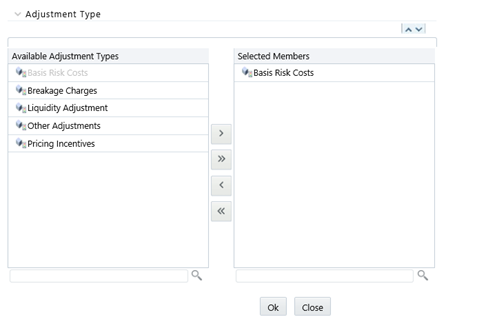

  1. Select the Adjustment Type from the Adjustment Type Selection shuttle box. From this list, you can select either Breakage Charge or any combination of other Adjustment Types.
    Next to each Adjustment Type, you can select a Transfer Pricing Rule. This TP Rule will be used to refer to TP Methods if you are planning to use the "Use TP Method from TP Rule" option.
    The list in the drop-down menu of Transfer Price Rules will be populated based on folder/product hierarchy selection.

    Figure 26-7 Adjustment Type Selection
    This screen allows you to select the Adjustment Type from the Adjustment Type Selection section.
  5. Select Apply to save the Adjustment Definition.
