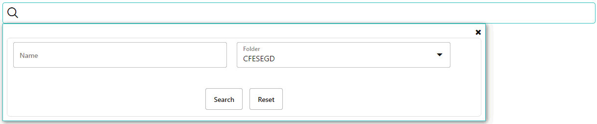

  1. Navigate to Prepayment Model Analysis window. Click Add . The Definition window is displayed.
    Figure 24-5 Prepayment Model Analysis

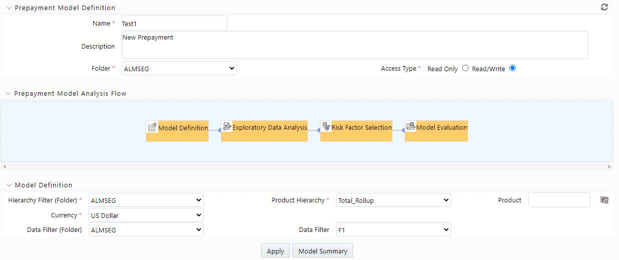

  2. Enter the following details.
    Table 24-4 Form Fields to define a Model
    Fields Description
    Name Enter the name of Prepayment Model Analysis rule
    Description Enter the description of Prepayment Model Analysis rule
    Folder Select the folder where you want to save Prepayment Model Analysis rule
    Access Type Select Access Type as Read-only or Read/Write.
    Hierarchy Filter (Folder) Select the folder of Hierarchy Filter.
    Product Hierarchy Select the Product Hierarchy.
    Product Based on the selected product hierarchy in model definition UI, Hierarchy Browser will expand the product hierarchy and you can select any parent/leaf node by clicking on the view button next to the product in the model definition screen.
    Currency Select the currency for the Prepayment Model Analysis rule. Default Currency option is also given, if you want to select the product irrespective of currency in which deal is booked.
    Data Filter (Folder) Select the folder name of data filter for Prepayment Model Analysis rule
    Data Filter Select the data filter to define the portfolio at more granular level than just, product and currency combination.
  3. Click Apply to navigate to Exploratory Data Analysis window.

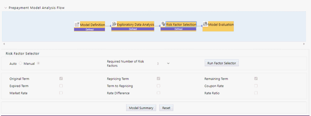

  7. Click Next. The Risk Factor Selection window is displayed. By default, all the risk factors will be disabled.
    Figure 24-7 Risk Factor Selection window
  8. You can change the risk factor selection mode to ‘Manual’ and all the risk factors would be available for selection; maximum 3 factors can be selected after that all the risk factors would be disabled again.
    When you are in Auto Select Mode, System would perform required calculations, co-relation/collinearity analysis in the backend based on the required number of risk factors (Maximum 3), System would auto-select the best representative set of risk factors as per the input data.
    If you want to change sample size and re-calculate EDA again, click Exploratory Data Analysis block and perform EDA with updated sample size. Again, the process starts from that step onwards, and updated EDA plots/graphs would be saved for the model.

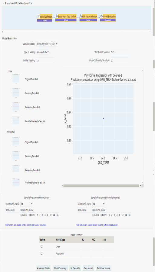

  9. Click Next to navigate to Model Evaluation window. A confirmation message is displayed. Click OK.
    Figure 24-8 Model Evaluation
    Model Evaluation
  10. Click Calculate to view all the evaluation parameters and quality plots.
  11. Click Re-Calculate if you are not satisfied with the model quality to change the model parameters and revise the model definition. You can zoom the graph to enhance visibility.
    If you are changing parameters and generating different versions of the model, then you can see all the versions, generated with different set of model parameters in the Versions (Model) drop-down. If you have run “model evaluation’ only once, then this drop-down would not be available. As per the selected version, the Advanced model details window is also updated. The Model Details window helps you to evaluate the model fit. It has the following comparisons:
    Predicted Values Vs Risk Factor 1,2,3, as per the number of risk factors considered for model building. This will dynamically adjust as per the number of risk factors selected.
    Predicted Values Vs Test Sample.

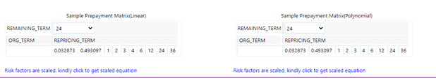

    Sample prepayment matrix as per both the models (Linear and Polynomial).
    Figure 24-9 Sample prepayment matrix
    User would have option to redefine, values for sample matrix by clicking on “Re-define Sample” button. Below pop up would open up if user would like to re-define sample buckets. Again this pop up would dynamically adjust based on number of risk factors selected in the model.

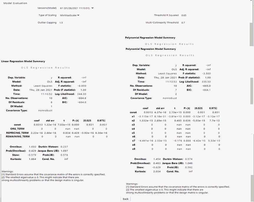

Advance Details – To verify the model quality, all the model statistics are given on a different screen, which would be available with ‘Advance Details’ button like R2, F value, P – Value, and so on.
Figure 24-11 Advance Details
Advance Details
Reset button on each screen would help to delete all the calculations done in subsequent steps. That is, if you have done EDA and selected particular EDA version to do further calculations like ‘Risk factor Selection’ or ‘Model Evaluation’. In case you are not satisfied with model, you can go back to EDA, click ‘Reset’ to clear out the details/calculations performed in subsequent stages and do recalculate with a different set of parameters.
