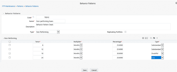

  1. In the Behavior Pattern Details Page, select Non-Performing as the Behavior Pattern Type.
  2. Enter the Code, Name, and Description for the Behavior Pattern.
  3. Click the Add icon to open the Non-Performing Behavior Patterns Summary page.
    Figure 15-4 Behavior Pattern with Type as Non-Performing
  4. Enter or select the following details:
