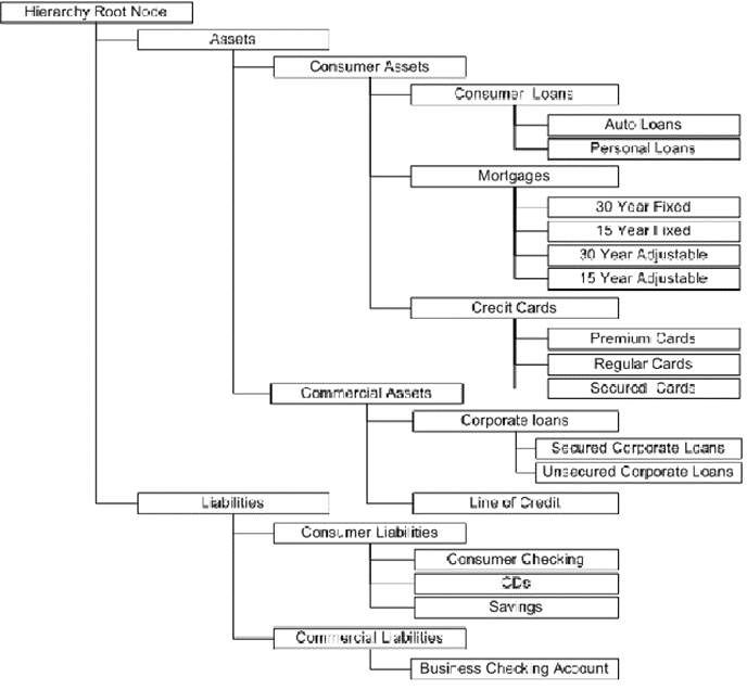

The following graphic displays a sample product hierarchy:
Figure 12-12 Sample Product Hierarchy
The Illustration displays a sample product hierarchy.
Suppose you want to transfer price this product hierarchy using the Spread from Interest Rate Code transfer pricing method except for the following products:
  • Mortgages: You want to transfer price these using the Zero Discount Factors cash flow based method.
  • Credit Cards: You want to transfer price all but secured credit cards using the Spread from Note Rate method.
To transfer price in this manner, you need to attach transfer-pricing methods to the nodes of the product hierarchy as follows:
  • Hierarchy Root Node: Spread from Interest Rate Code
  • Mortgages: Zero Discount Factors Cash Flow
  • Credit Cards: Spread from Note Rate
  • Secured Credit Cards: Spread from Interest Rate Code
The transfer pricing method for a particular product is determined by searching up the nodes in the hierarchy. Consider the Secured Credit Cards in the previous example. Since the Spread from IRC is specified at the leaf level, the system does not need to search any further to calculate the transfer rates for the Secured Credit Cards. However, for a Premium Credit Card, the system searches up the hierarchical nodes for the first node that specifies a method. The first node that specifies a method for the Premium Credit Card is the Credit Card node and it is associated with the Spread from Note Rate method.
