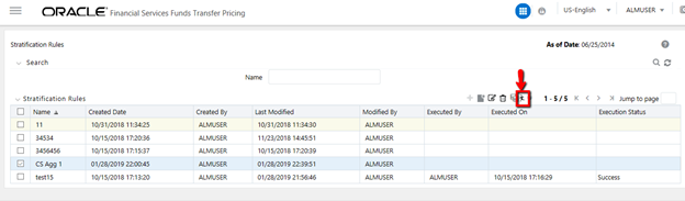

32.5.5 Executing a Stratification Rule
To execute a stratification rule, follow these steps:
  1. Navigate to the Stratification Rule Summary page.
    Figure 32-7 Stratification Rules
  2. Select the Stratification Rule you want to process.
  3. Select the Run icon.
  4. Select the As-of-Date for the instrument data you want to aggregate.
  5. Select OK to begin the process.
