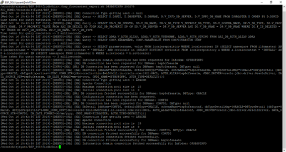

    Figure E-1 Export Dimensions using Putty Session
    This illustration is a sample screen for exporting the Dimensions using Putty session.

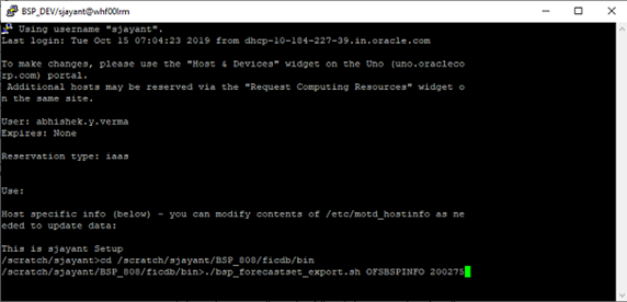

    Figure E-2 Export Dimensions using Putty Session
