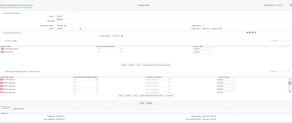

Figure 22-1 Forecast Rates Features
This screen displays the features of the Forecast Rates.
