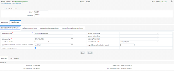

Following is a listing of new business fields used in the Product Characteristics rule > Core Product Attributes tab.
Figure 21-4 Core Product Attributes Tab
This screen allows you to add the Core Product Attributes to the Product Profile.
Table 21-3 Core Product Attributes Tab Fields and Descriptions
Field Description
Amortization Type
Method of amortizing principal and interest. The choices consist of all standard OFSAA codes and all additional user-defined codes created through the Payment Pattern and Behavior Pattern interfaces, as given below:
  • Conventional Fixed
  • Conventional Adjustable
  • Balloon Payment
  • Adjustable Negative Amortization
  • Non-Amortizing
  • Rule of 78's
  • Level Principal
  • Payment Pattern
  • Behavior Pattern
  • Lease
Adjustable Type
Determines the repricing characteristics of the new business record. The choices consist of all standard OFSAA codes plus a Repricing Pattern. The standard OFSAA codes are as follows:
  • Fixed-Rate
  • Floating Rate
  • Other Adjustable
Lease Residual Value For Lease instruments, this value specifies the residual amount as a percent of the par balance.
Amortization Method for Premiums, Discounts, and Fees
Determines the method used for amortizing premiums, discounts, or fees. The available codes are:
  • Level Yield
  • Straight Line
Behavior Pattern Code Lists all user-defined behavior patterns created through the user interface.
Payment Pattern Code Lists all user-defined payment patterns defined through the user interface.
Repricing Pattern Code Lists all user-defined reprice patterns created through the user interface.
Interest Rate Code Defines the pricing index to which the instrument interest rate is contractually tied. The interest rate codes appear as a selection option depending on the choice of currency. The interest rate code list is restricted to codes that have the selected currency as the reference currency. If the default currency is chosen, all interest rate codes are available as a selection.
Original Deferred Amortization Percent The initial deferred balance is expressed as a percent of the original par balance.
Inflation-Indexed Instrument Check box to model instrument as Inflation-Indexed.

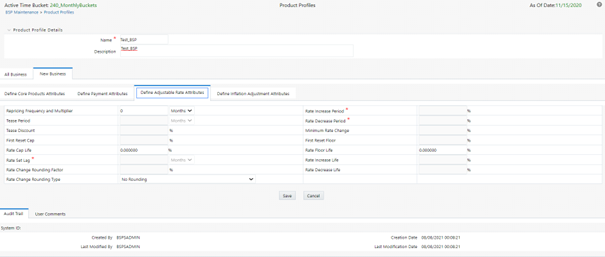

Following is a listing of new business fields used in the Product Characteristics rule > Adjustable Rate Attributes tab:
Figure 21-6 Adjustable Rate Attributes tab
This screen allows you to add the Adjustable Rate Attributes to the Product Profile.
Table 21-5 Adjustable Rate Attributes Tab Fields and Descriptions
Field Description
Repricing Frequency Contractual frequency of rate adjustment
Tease Period The tease period is used to determine the length of the tease period.
Tease Discount The tease discount is used in conjunction with the original rate to calculate the tease rate. The tease rate is the original rate less the tease discount.
First Reset Cap
This indicates the maximum delta between the initial rate and the first reset for mortgage instruments that have a tease period. This rate will be applicable at the tease end period, before the first reset. After this, the periodic and lifetime cap value will be applied. The value of this field will be automatically populated from the Product Profile window if the product is mapped to Product Profile and the value is defined for First Reset Cap.
For example:
Current Rate = 3.5% (from the instrument record)
Margin = 0.3 %
First Reset Cap = 0.5% (from the instrument record)
First Reset Floor = 0.1% (from the instrument record)
Scenario 1: If New Forecasted Rate = 5.1% (Forecast Rates Assumption)
Fully indexed rate (after applying minimum rate change, rounding effects) is higher than the (Current Rate + First Reset Cap). So, the new rate assigned will be 3.5% + 0.5% = 4.0%
First Reset Floor This is the initial minimum value for mortgage instruments that have a tease period. This floor rate will be applicable at the tease end period, before the first reset. After this, the periodic and lifetime floor value will be applied. The value of this field will be automatically populated from the Product Profile window if the product is mapped to Product Profile and value is defined in for First Reset Floor.
Rate Cap Life The maximum rate for the life of the instrument.
Rate Set Lag Period by which the rate lookup lags the repricing event date.
Rate Change Rounding Factor Percent to which the rate change on an adjustable instrument is rounded.
Rate Change Rounding Type The method used for rounding of interest rate codes. The choices are as follows: no rounding, truncate, round up, round down, round nearest.
Rate Increase Period The maximum interest rate increase allowed during the cycle on an adjustable-rate instrument.
Rate Decrease Period The maximum amount rate can decrease during the repricing period of an adjustable-rate instrument.
Minimum Rate Change The minimum required change in rate on a repricing date.
Rate Floor Life The minimum rate for the life of the instrument.
Rate Increase Life Maximum interest rate increase allowed during the life of an adjustable-rate instrument used to calculate rate cap based on forecasted rate scenario. If both rate increase life and rate cap are defined, the process uses the more restrictive rate.
Rate Decrease Life The maximum amount rate can decrease during the life of an adjustable-rate instrument, used to calculate the rate floor based on the forecasted rate scenario. If both rates decrease the life and rate floor are defined, the process uses the more restrictive rate.
