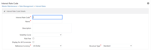

33.2.1.1 Rate Management
In the Rate Management Interest Rates detail screen, is a drop-down list called the Curve Identifier. This is a drop-down list that contains the list of 4 curve identifier types, that is, par treasury, zero coupon treasury, par LIBOR/swap, and zero coupon LIBOR swap. These curve identifiers can be mapped to the seven indices to be used with the Adjustable Rate Mortgages(ARMs) meant for ADCo purpose, whose reference currency is always US Dollar.
Figure 33-1 Interest Rates Maintenance Screen
