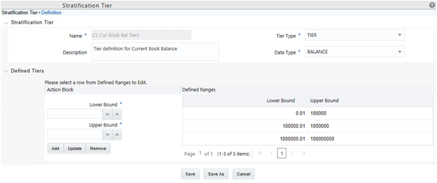

Use the Tier Definition page to define stratification criteria for creating a finite number of pools that are used by the Stratification Definition - Group by page.
Figure 32-2 Stratification Tier – Definition page
This example illustrates the fields and controls on the Tier Structures page. You can find definitions for the fields and controls later in this guide.
Input the lower and upper boundary amounts for each tier and then add to the definition. The lower bound range must be greater than the prior upper bound amount. These values cannot be equal and do not overlap. The initial lower bound and last upper bound should small enough and large enough to capture all possible values.
