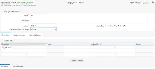

The following diagram illustrates a three-driver prepayment model:
Figure 12-1 Prepayment Model
The Prepayment Models screen allows you to define a new prepayment model.
The ~ signifies a point on the X-Y-Z plane. In this example, it is on the second node of the Z-plane. The Z -plane behaves like layers.
Oracle Balance Sheet Planning allows you to build prepayment models using the Prepayment Model rule. The Prepayment Model rule can then be referenced by a Prepayment Rule. See Prepayment Models.
