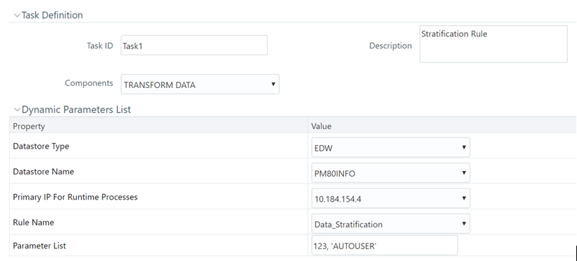

To execute the procedure from OFSAAI ICC framework, create a new Batch with task as TRANSFORM DATA and specify the following parameters for the task:
  • Datastore Type: Select appropriate Datastore from the list
  • Datastore Name: Select appropriate name from the list
  • IP Address: Select the IP address from the list
  • Rule Name: Data_Stratification
  • Parameter List: stratification_id, user_name
Figure 32-8 Stratification using ICC Batch Framework
