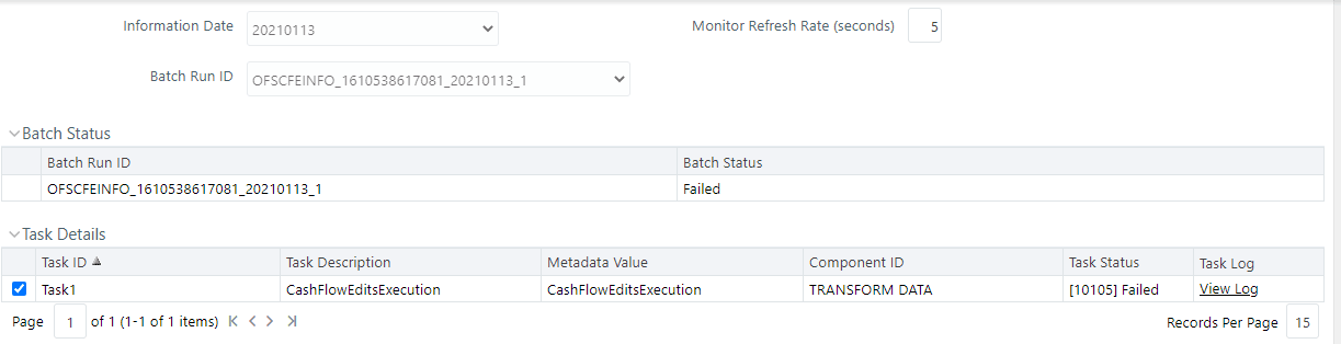

You can view the log using Batch Monitor also. To view the logs from Batch Monitor, follow these steps:
- Navigate to Common Object Maintenance, select Operations, and then select Batch Monitor.
- Select the Batch Run ID.
- View the Task Details of Cash Flow Edits Execution.
Figure 14-8 View the Task Details
- Click View Log.
