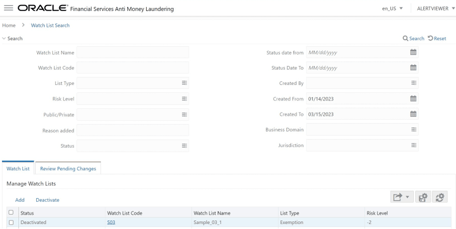

  1. Navigate to the Manage Watch Lists Search and List page.
    Figure -11 Manage Watch Lists page
  2. Enter the following information in the respective fields.
    Table -7 Watch List Search Section Filters

  3. Click Go.
    The relevant list of watch lists is displayed.
