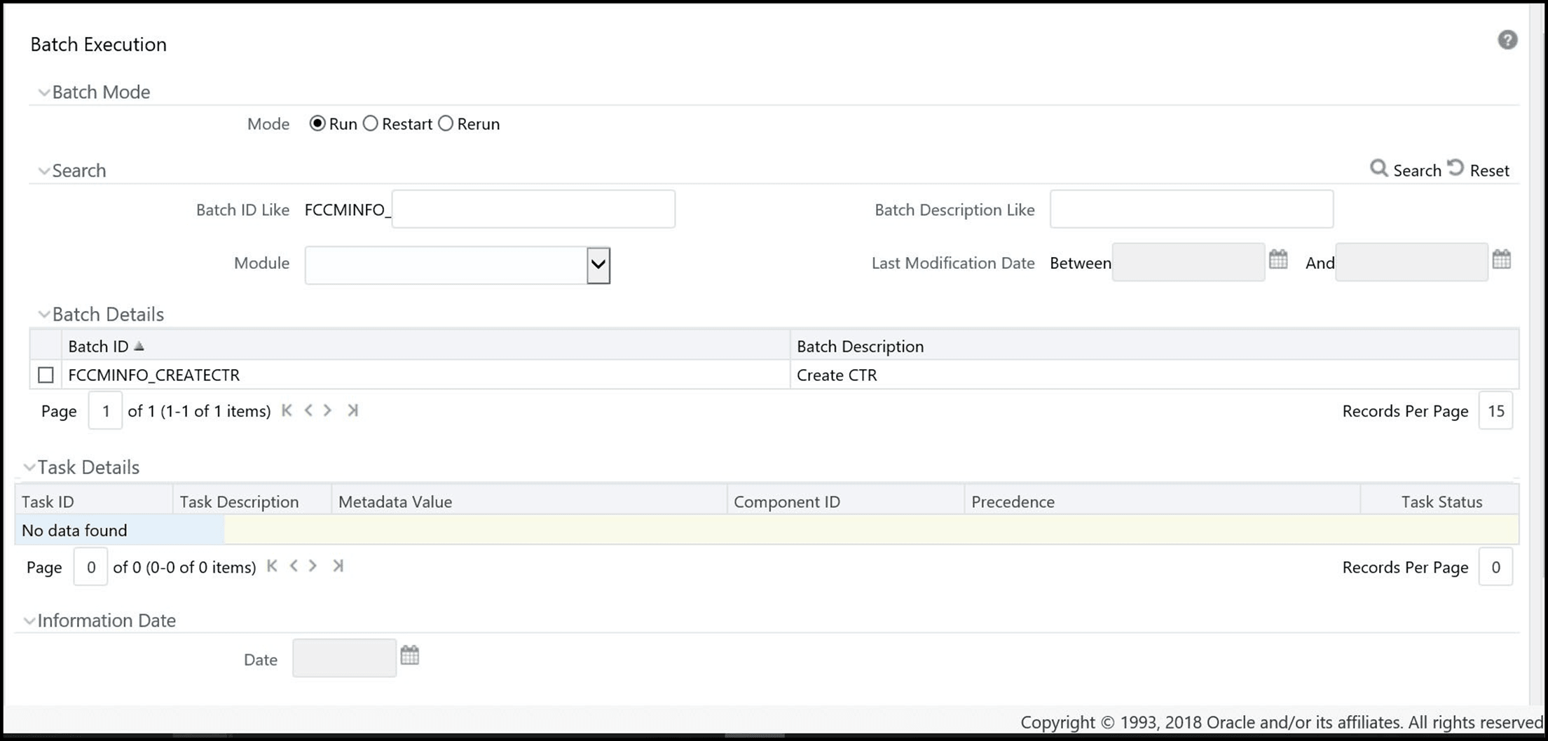

- Click Batch Execution.
Figure 7-1 CTR Batch Execution
- Select the batch (Create CTR) from the Batch Details section.

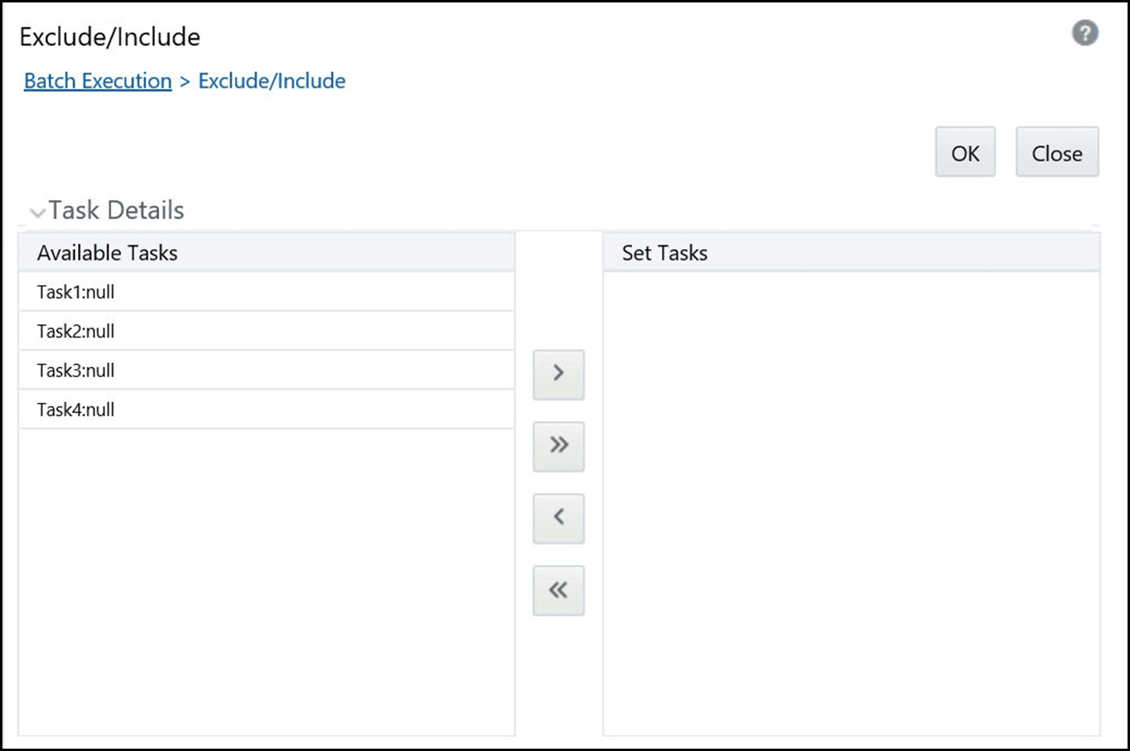

- To set the tasks which will run with this batch, click
Exclude/Include in the Task details.
The Task Mapping window displays.
Figure 7-2 Task Mapping Window
- Keep the required tasks that you want to execute under the Available Tasks and move the rest to the Set Tasks section.

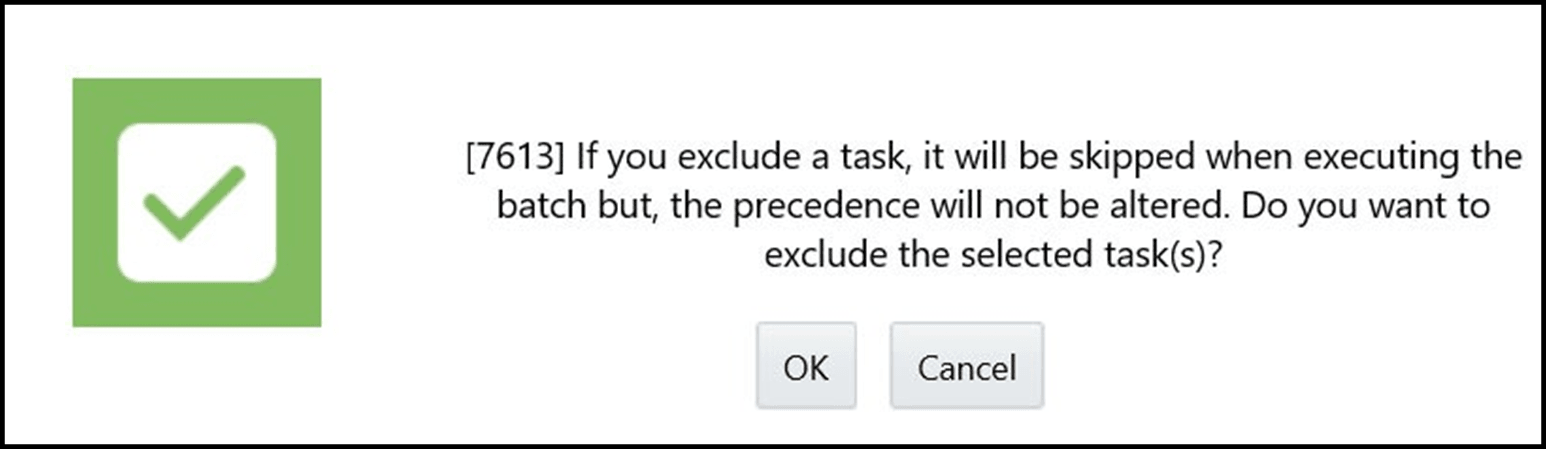

- Click OK. A warning message displays:
Figure 7-3 Warning Message

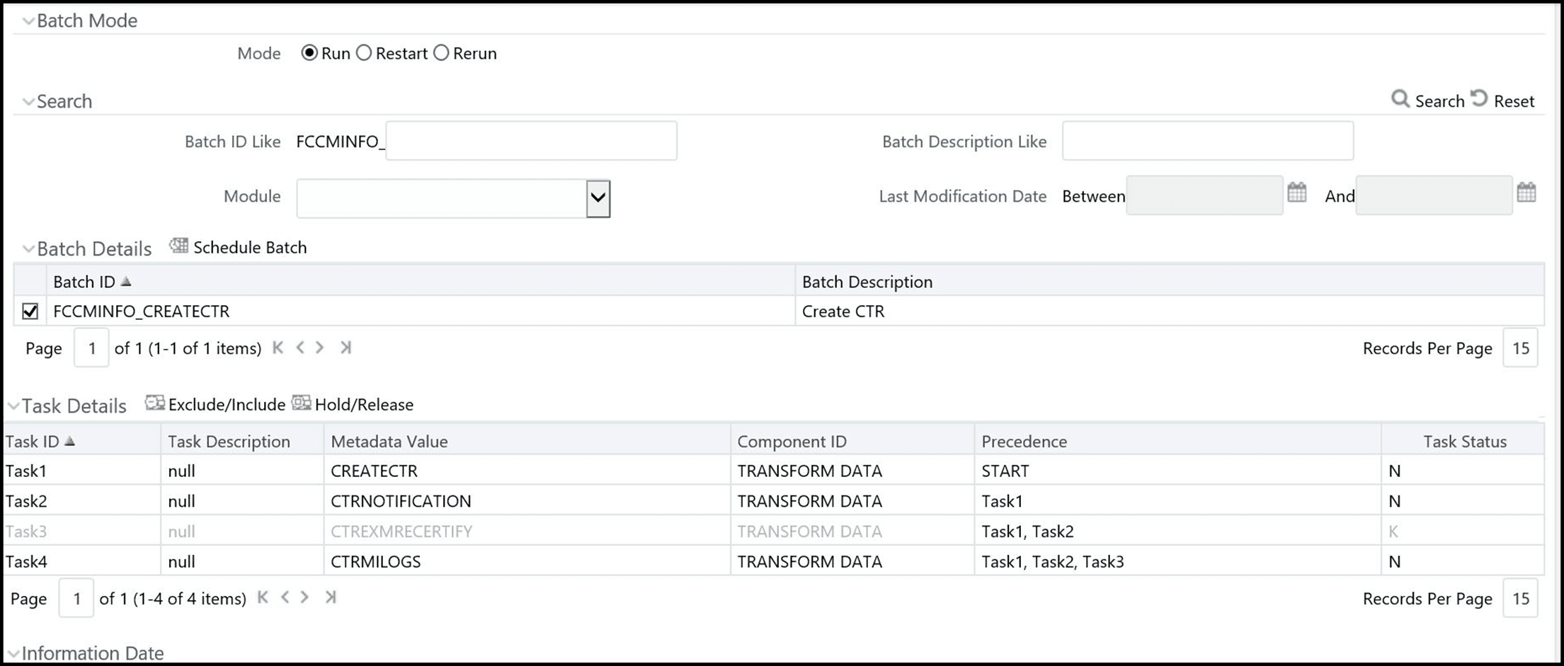

- Click OK. The Batch Execution screen is displayed with the
selected tasks to be executed.
Figure 7-4 CTR Batch Execution - Tasks Details
