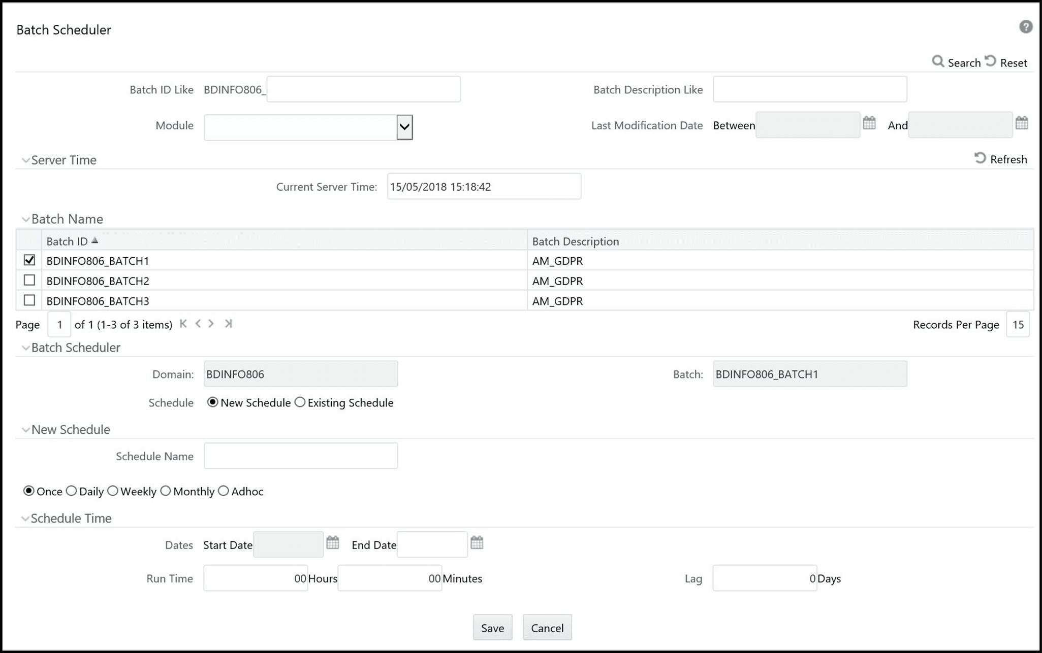

  7. Enter the schedule time of the batch by specifying the Start Date and the Run Time.
    Figure 10-1 Scheduling a Batch Once
  8. Click Save. The batch will run at the specified date and time.
