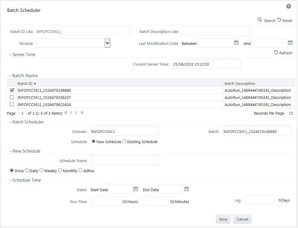

  5. Select a batch you want to schedule from the list of available batches. The Batch Scheduler section is expanded and displays additional options.
  6. Click New Schedule.
  7. Set the frequency of the new schedule as Once.
  8. Enter the scheduled time of the batch by specifying the Start Date and the Run-Time.
    Figure 6: Batch Scheduler Filter Fields
    Figure 7-1 Batch Scheduler Filter Field
  9. Click Save.
