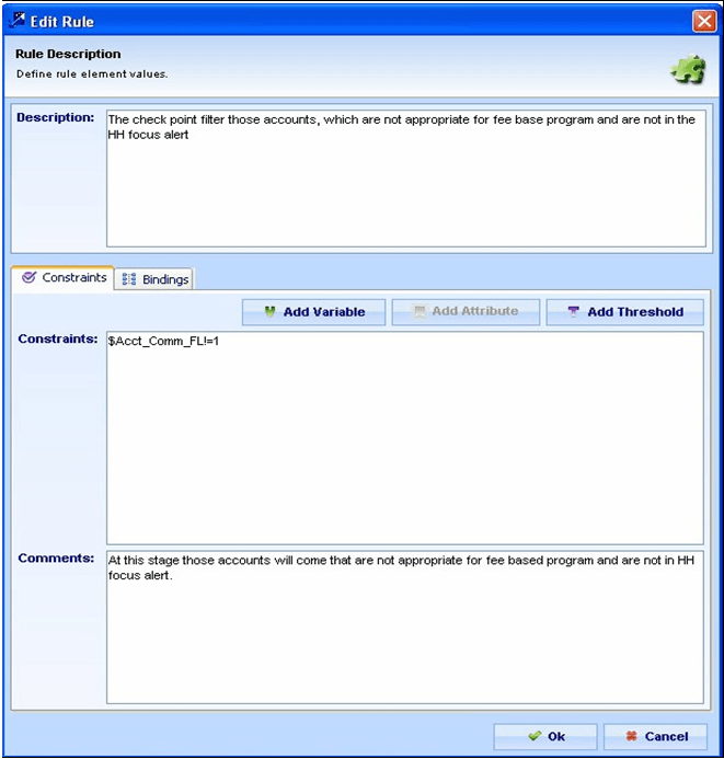

The Edit Rule dialog box for Checkpoint enables you to specify constraints and bindings for any checkpoint that you add to the rule pattern.
Figure 8-10 Edit Rule Dialog Box—Checkpoint
The Edit Rule dialog box for Checkpoint contains the Description field, in which you can specify a description for a checkpoint. The specified value displays in the Pattern Editor area of the Rule Scenario Editor dialog box (Checkpoint [value]).

    The new rule displays as Checkpoint [NO DESCRIPTION] in the Pattern Editor area.
  5. Double-click the Checkpoint [NO DESCRIPTION] string.
    The Edit Rule dialog box for Checkpoint displays showing the Checkpoint you want to name
  6. Type the description of the checkpoint in the Description field.
  7. Click Ok.
    The Rule Scenario Editor window displays the specified description in the Pattern Editor area.
