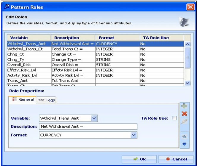

Pattern Roles General Tab
The General tab enables you to specify elements for defining a role in your pattern.
Figure 8-11 Pattern Roles Dialog Box—General Tab
The Pattern Roles General tab contains the following elements:
- Pattern Roles grid: Lists all roles defined for a rule scenario.
- Variable: Enables you to select the variables you want to save to the KDD_BREAK_BINDING table. Clicking the column header orders the list of roles alphabetically by variable name.
- Description: Enables you to specify any additional information to include in a role. Clicking the column header orders the list of roles alphabetically by description.
- Format: Enables you to select the desired format and to define whether or not to display the specified variable. If you select the <NOT DISPLAYED> option in the drop-down list, the variable does not display in the Web Application.
- TA Role Use: Enables you to specify if a pattern role variable should be available for the threshold analyzer role in Threshold Analyzer Roles dialog box. By default, the TA Role Use check box is clear.
- Add: Saves the specified pattern role information.
- Modify: Applies changes to a pattern role.
- Delete: Deletes a pattern role. Clicking the Delete button removes the variable from the KDD_PT- TRN_ROLE table, and the associated variable from the KDD_TA_ROLES table on the condition that no other patterns for a scenario should have a pattern role record for that particular variable.
- Move Up: Changes the order of a role by moving the selected role up.
- Move Down: Changes the order of a role by moving the selected role down.
- OK: Saves, changes, and closes the dialog box.
- Cancel: Cancels any changes and retains the previously saved role information.

To define elements of a pattern role, follow these steps:
- From the Windows menu of the DataSet Editor, select
Rule Patterns.
The Rule Scenario Editor window displays.
- From the scenario navigation tree area, navigate to the desired pattern element.
- 3. In the Pattern area, click Edit Roles.
The Pattern Roles dialog box displays.
- Select the desired variable from the Variable drop-down list.
- Type the text you want associated with this role in the Description field.
- Click the arrow of the Format drop-down list to identify the highlights from other pattern roles, and to define the display of the pattern roles on the Web Application pages (refer to above table for details about the options for this field).
- Select the TA Role Use check box if you want to assign pattern role variable to a threshold analyzer role.
- Click Ok.
