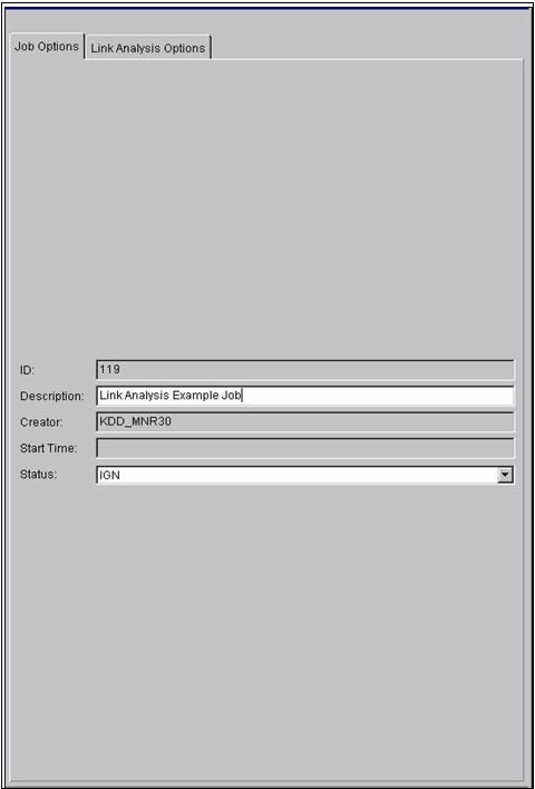

7.5.1.3 Job Options Tab
The Job Options tab enables you to enter a description of the Link Analysis job and define its status.
Figure 7-12 Job Options Tab
Job Options Tab
The components of the Job Options Tab include the following:
  • ID: Non-editable.
    • When creating a new job, the text box is null; when you save the job, the system assigns an ID to the job.
    • When modifying an existing job, the text box contains the ID assigned to the selected job.
  • Description: This field enables you to describe the Link Analysis job.
    • When creating a new job, the text box is null.
    • When modifying an existing job, the text box contains the description of the selected job.
  • Creator: Non-editable.
    • When creating a new job, the text box is null; when you save the job, the system assigns a User ID to the job.
    • When modifying an existing job, the text box contains the user ID of the person that created the job.
  • Start Time: Non-editable.
    • When modifying an existing job, the text box contains the date the job was last executed.
  • Status: This field enables you to define the status of the Link Analysis job.
    • When creating a new job, the drop-down list contains the options: NEW (the default) or IGN (Ignore).
    • When modifying an existing job that has been executed or is currently being executed, the drop-down list contains the options that represent the status of the job. If the status is ERR, the RES option is added to the drop-down list.
