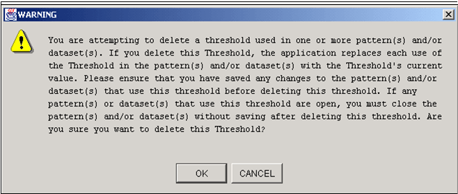

    The Warning dialog box displays.
    Figure 9-6 Warning Dialog Box
    Warning Dialog Box
  4. Click OK to confirm that you want to remove the threshold from the selected pattern or dataset.
    The pattern or dataset is removed from the list.
  5. Click Save to confirm the removal of the pattern or dataset. The Threshold Manager dialog box closes.
    If you do not want to remove the selected threshold from the pattern or dataset you selected, click CANCEL.
