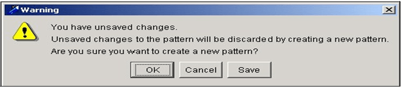

After completing configuration of scenario, make sure to save the information.
To save a scenario, follow these steps:
  1. From the File menu, select Close.
    A Warning dialog box displays.
    Figure 6-12 Save Scenario Dialog Box
  2. Click Save and close the scenario.
    The system saves the scenario with the name you defined in the Name field on the Sequence Scenario Editor dialog box.
    To close and discard the new scenario (or any entered information), click OK. To cancel the operation and keep the scenario open, click Cancel.
    You have completed all of the procedures required to create a sequence scenario successfully.
