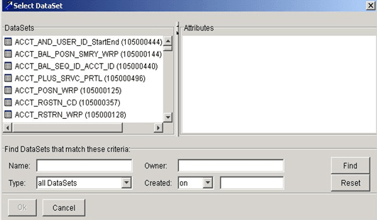

You can select each dataset in the Select DataSet dialog box.
Figure 4-1 Select DataSet Dialog Box
The following table describes the components of the Select DataSet dialog box.
Table 4-2 SelectDataSet Dialog Box Components
Column Description
Data Sets Lists all available datasets, based on the specified domain.
Attributes Displays the attributes associated with the selected dataset in the DataSets area
Find Data Sets Enables you to define the search criteria for a dataset as follows:
  • Name: Dataset name.
  • Owner:Owner of the dataset.
  • Type:
    • All DataSets: Search all datasets.
    • RealizedDataSets: Search for realized or derived datasets.
      Selecting either All DataSets or Realized DataSets displays the same output.
    • WrapperDataSets: Search for wrapper datasets.
  • Created: This specifies whether to search for datasets before, on, or after the date you enter in the Date Entry field, as mm/dd/yyyy.
