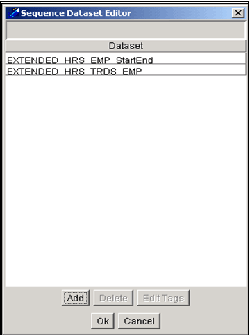

    The Sequence Dataset Editor dialog box displays.
    Figure 6-5 Sequence Dataset Editor Dialog Box

  5. Click Add in the dialog box to view available datasets.
  6. Click the dataset you want to add to your sort.
  7. Click Ok.
    The selected dataset name displays in the Sequence Dataset Editor dialog box.
