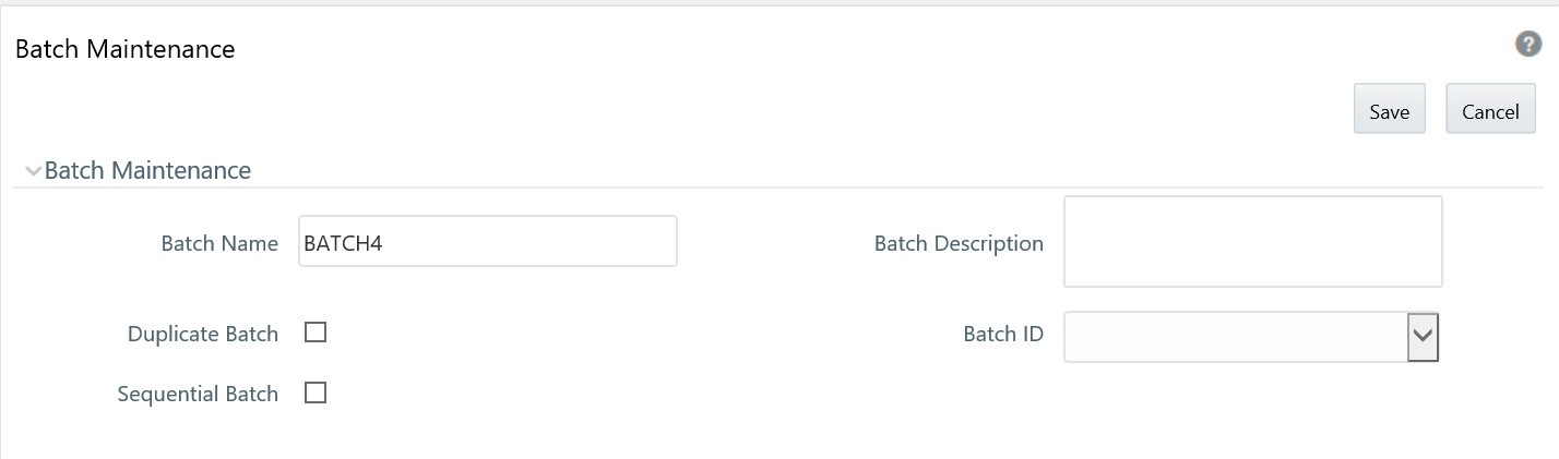

5.6.1 Adding Behavior Detection Batches
To add a batch, follow these steps:
- Login as the Administrator. The OFSAAI Applications page is displayed.
- Click Trade Based Anti Money Laundering.
- In the Navigation List, select Operations, then
Batch Maintenance. The Batch Maintenance page is
displayed.
- In the Batch Name section, click Add. The Add Batch
Definition page is displayed.
- Enter the batch details as described in the following table:
Table 5-6 New Batch Details
Field Description Batch Name Enter the name for the new batch. Batch Description Enter a description for this batch. Duplicate Batch Select this check box if the batch is a duplicate batch. Sequential Batch Select this check box if the batch must be run sequentially to another batch Batch ID The Batch ID will be auto-populated. - Click Save. The added batch appears in the Batch Name section of the Batch Maintenance page.
