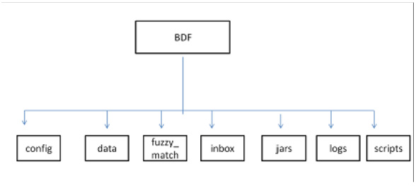

D.3 Directory Structure
<OFSAAI
Installed Directory>/ bdf file.
Table D-12 Directory Structure Description
| Directory Name | Description |
| scripts | Shell scripts for running components, setting the environment, and changing passwords |
| logs | Log files containing status and error messages produced by components |
| config | Files used to configure components |
| config/datamaps | XML files containing data map definitions for individual components |
| jars | Java Archive (JAR) files used to run components |
| data/errors | Files containing error records produced by components |
| data/temp | Temporary files produced by components |
| inbox | Data files provided by the Oracle client in DIS format |
| fuzzy_match | C++library files used for the purpose of fuzzy matching names |
