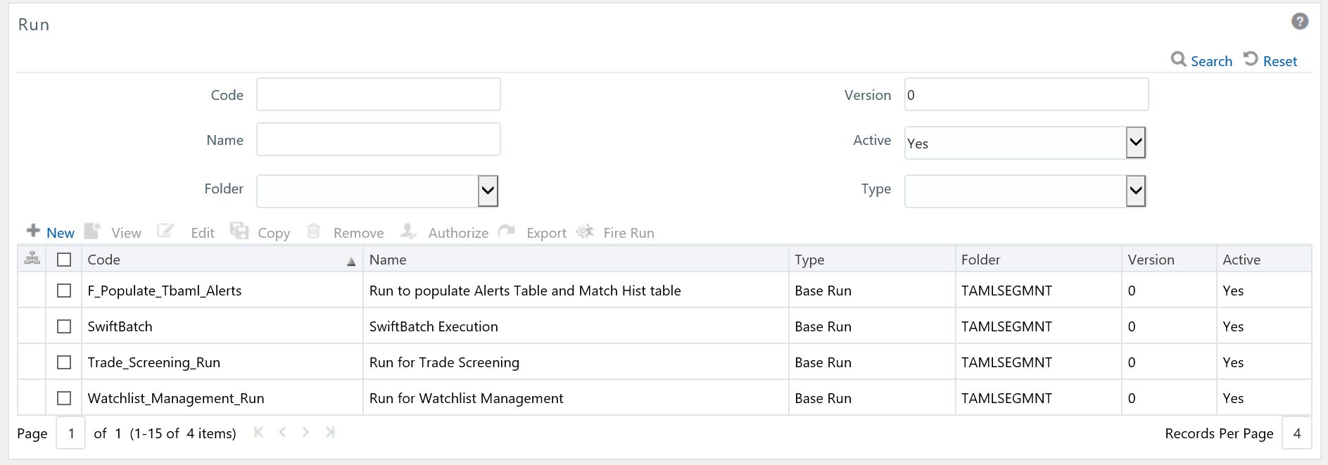

- In the Navigation List, select Operations, then click Run Rule Framework.

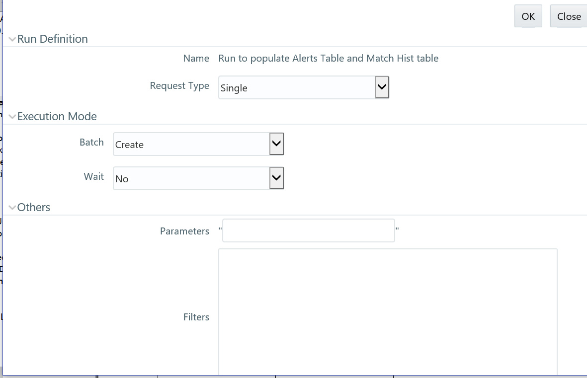

- Click Run. The Run page is displayed with the available
batch jobs.
- Select the batch job that is to be executed and click Fire
Run. The Fire Run window is displayed.
- Enter the following details:
Table 5-7 Adding Fire Run Details
Field Description Request Type Select Request Type based on the following options: - Single: If the batch must be executed once.
- Multiple: If the batch must be executed multiple times at different intervals.
Batch Select Batch. It has the following options: - Create
- Create & Execute
Wait Select Wait. It has the following options: - Yes: This executes the batch after a certain duration. Enter the duration as required.
- No: This executes the batch immediately.
Parameters Enter the parameters for this batch. Filters Enter the filter details. Note: $MISDATE option can be used to execute the run for that particular day. The format for it to enter in the filter details is: to_date(<ACTIVITY_TABLE_NAME>.<ACTIVITY_DT_COL>)=$MISDATE
Note: For $MISDATE option:- For either Date or Timestamp datatypes, to_date is mandatory for the filter.
- Activity Table Name and Activity Column Name should be in capital.
- Click OK to run the batch. The following message is
displayed: Batch Execution is in progress.
