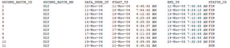

Column Name Description PRCSNG_BATCH_ID Current batch process ID. PRCSNG_BATCH_NM Name of the current batch process. DATA_DUMP_DT Business day on which the batch ran. START_TS Time that the batch started. END_TS Time that the batch ended (if applicable). STATUS_CD Status code that indicates whether the batch is currently running (RUN) or has finished (FIN). - The Batch Control Utility logs a message in the <
OFSAAI Installed Directory>/ database/ db_tools/logs/batch_control.logfile, stating that the batch process has begun.Querying theKDD_PRCSNG_BATCH_HISTtable for confirmation that the batch has started displays information similar to that in the following Figure. In the last entry, note the appearance ofRUNforSTATUS_CDand lack of end time inEND_TS.Figure 7-2 Sample KDD_PRCSNG_BATCH_HIST Table—Batch Start Status
