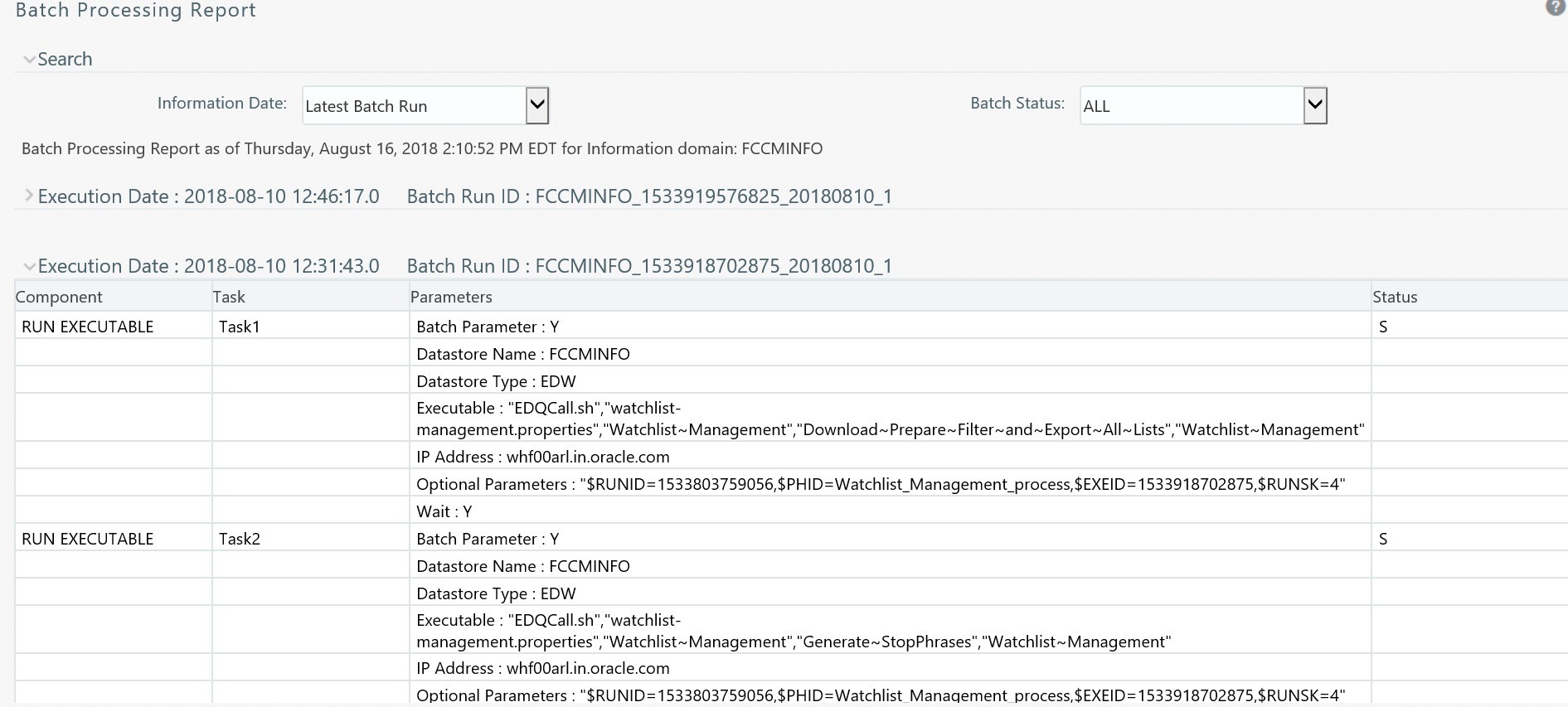

5.6.14 Managing the Batch Processing Report
The Batch Processing Report allows you to view parameter details for batches in the following statuses:
  • Not Started
  • Ongoing
  • Complete
  • Failed
  • Canceled
Figure 5-15 Batch Processing Report
To view a report, follow these steps:
  1. Login as the Administrator. The OFSAAI Applications page is displayed.
  2. Click Trade Based Anti Money Laundering.
  3. In the Navigation List, select Operations, then click Processing Report.
  4. In the Search bar, select the Information Date and Batch Status from the drop-down lists. All applicable reports will be listed by Execution Date and Batch Run ID.
  5. Click
    Expand icon
    to expand the report you wish to view details for
