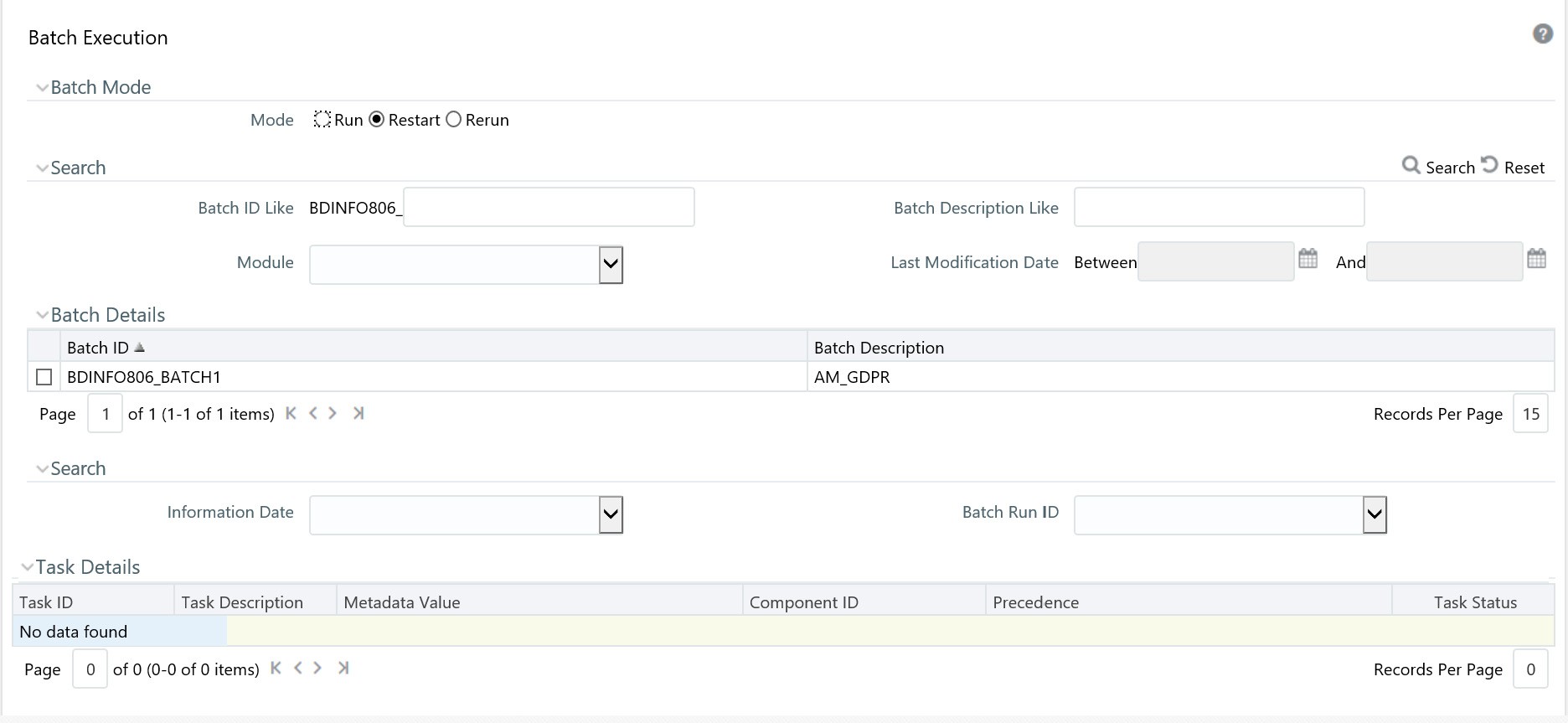

To restart a batch execution, follow these steps:
  1. Login as the Administrator. The OFSAAI Applications page is displayed.
  2. Click Trade Based Anti Money Laundering.
  3. In the Navigation List, select Operations, then click Batch Execution. The Batch Execution page is displayed.
  4. Select Restart from the Batch Mode section.
    Figure 5-13 Re-starting a Batch
  5. Select the batch from the Batch Details section that you want to restart.
  6. Select the Information Date and Batch Run ID for the selected batch from the drop-down list.
  7. Click Execute Batch.
