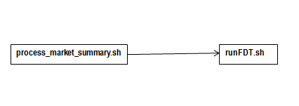

For firms using the MiFID scenarios and running a single end-of-day batch, the process_market_summary.sh script must be executed prior to running the runFDT.sh script such that the 4-wk ADTV for the Current Business Day incorporates the published Current Day Traded Volume.
The following figure depicts dependency between the process_market_summary.sh script and the runFDT.sh script. For intra-day batch ingestion or intra-day execution of the MiFID scenarios, the process flow does not change from this structure. Since the current day’s 4-wk ADTV is not available until the end of the day, the previous day’s 4-wk ADTV is used to determine order size. For additional information on configuring the percentage values used to define a MiFID-eligible order as Small, Medium, or Large, see section Market Supplementary Guidance, in the Data Interface Specification.
Figure D-3 Dependency between process_market_summary.sh and runFDT.sh
