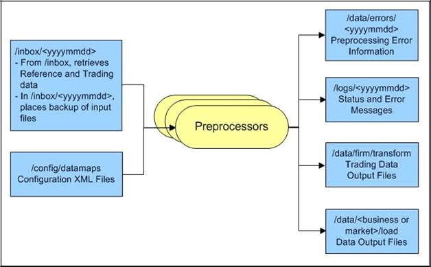

Using Pre-processing and Loading
The pre-processor component (runDP) use XML configuration files in the /config/datamaps directory to verify that the format of the incoming Oracle client data is correct and validate its content, specifically:
- Error-checking of input data
- Assigning sequence IDs to records
- Resolving cross-references to reference data
- Checking for missing records
- Flagging data for insertion or update
The Pre-processor addresses only those files that match naming conventions that the DIS describes, and which have the date and batch name portions of the file names that match the current data processing date and batch. Oracle clients must only supply file types required by the solution sets on their implementation.To load data in the FSDM using Pre-processing and Loading, follow these steps:
- Place the ASCII.dat flat files in the
<OFSAAI Installed Directory>/ ingestion_manager/inbox
directory. The component then performs data validation and prepares the data for further processing. - Execute runDP and runDL using the following sample scripts:
- For runDP:
<OFSAAI InstalledDirectory>/ingestion_manager/scripts/runDP.sh AccessEvents
- For runDL:
<OFSAAI InstalledDirectory>/ingestion_manager/scripts/runDL.sh AccessEvents

For flat files, Behavior Detection receives firm data in ASCII.dat flat files, which an Oracle client's data extraction process places in the /inbox directory.
