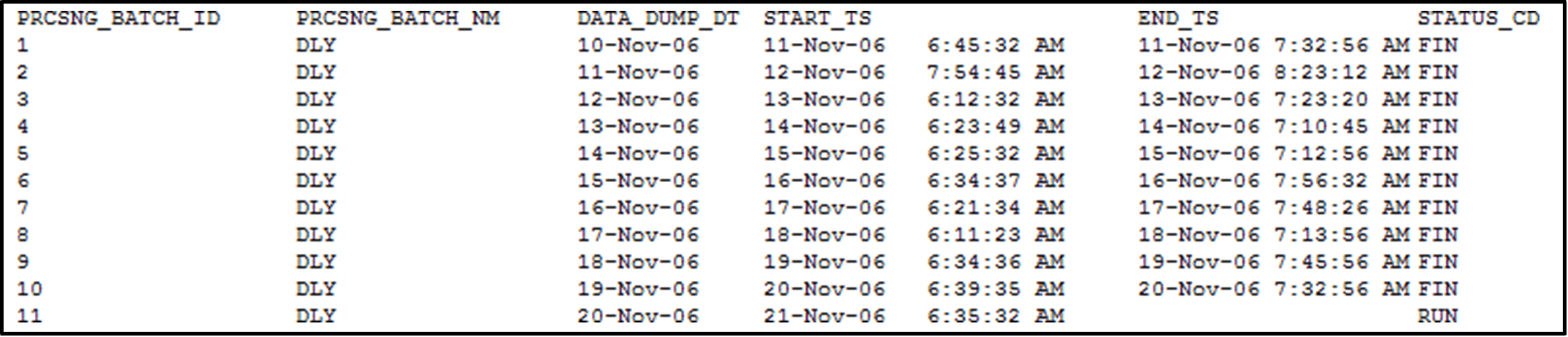

    Querying the KDD_PRCSNG_BATCH_HIST table for confirmation that the batch has started displays information similar to that shown below. In the last entry, note the appearance of RUN for STATUS_CD and lack of end time in END_TS.
    Figure 7-2 Sample KDD_PRCSNG_BATCH_HIST Table—Batch Start Status
