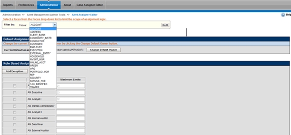

Alert Assigner Editor
In the Alert Assigner Editor, you must select a focus to view all of the assignment rules associated to that focus.
Figure 6-1 Alert Assigner Editor
The components of the Alert Assigner Editor include the following:
  • Search Bar
  • Default Assignment Owner Selector
  • Assignment Rule List for <Focus> Focus
  • Role Based Assignment Limits Editor

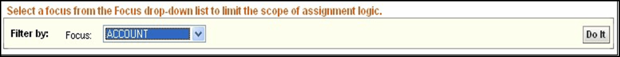

Search Bar
The search bar allows you to filter the list of assignment rules by the focus.
Figure 6-2 Alert Assigner Editor Search Bar
The components of the search bar include the following:
  • Filter by: Focus drop-down list: Provides a list of focus types. The values in the Focus drop-down list are sorted in ascending alphabetic order.
  • Do It button: When clicked, displays the assignment rules associated with the selected focus.

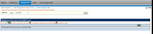

The assignment rule list displays in the Alert Assigner Editor after you select a focus in the search bar and click Do It. The rules in the list are sorted in ascending order by operation set number.
Figure 6-4 Assignment Rule List for <Focus> Focus
The Assignment Rule List for <Focus> Focus includes the following components:
  • Addbutton: Navigates you to the Assignment Rule Editor.
  • Updatebutton: Navigates you to the Assignment Rule Editor.
  • Deletebutton: Deletes the assignment rule.
  • Assignment Rule List for <Focus> Focus page displays the column headings: Operation Set, Attribute, Operator, Value, Next Operation Set, Strategy, and Owner. Refer to Assignment Rule Editor for more information.

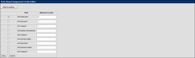

The Role Based Assignment Limits Editor allows you to limit the number of alerts that can be assigned to members of a pool based on user role. For example, if a member pool contains 25 investigators, you can limit junior investigators to have a maximum of 10 alerts assigned to them, and assign a senior investigator no cap.
Alerts are assigned based on the available assignment rules until members reach their caps, then alerts are assignedonly to members who have not reached their caps. If all members have reached their limit, alerts are assigned to the pool, and can be accessed by using the Auto-Assignment option in the Alert Workflow.
Figure 6-5 Role Based Assignment Limits Editor
The Role Based Assignment Limits Editor includes the following components:
  • User Role grid: When a user role is selected, you can edit the maximum limit. A Nullvalue indicates there is no limit for the assignment of alerts.
  • Add Exception button: Allows you to enter exceptions to the limit assigned to the user role. For example, to set a new limit for a specific user in a role. Refer to Adding an Exception to a Role Based Assignment Limit for more information.
  • Save button: Saves all modifications to the database.
  • Cancel button: Redisplays the Assignment Editor. The New Maximum Limits value is not saved.
