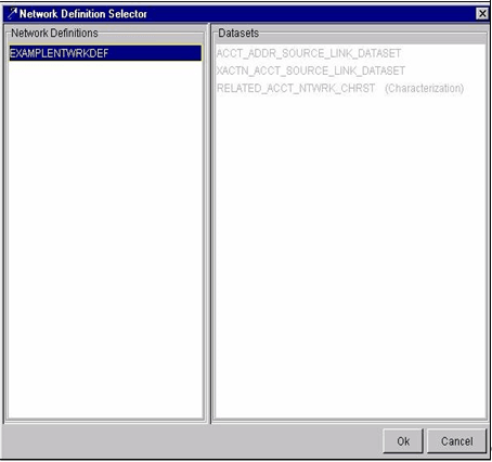

  1. From the File menu of the Link Analysis Network Definition Editor, select Open.
    The Network Definition Selector dialog box displays.
    Figure 7-6 Network Definition Selector Dialog Box
  2. Select the desired Network Definition in the Network Definitions area.
    The Network Definitions area populates with each Network Definition within the domain. The Network Characteristics dataset associated to the selected Network Definition display in the DataSets area (for example, Sample). In addition, the DataSets area lists the Source Link datasets and identifies them with the Characterization text (for example, RELATED_ACCT_ NTWRK_CHRST).
  3. Click OK.
    The system opens the selected Network Definition in the Link Analysis Network Definition Editor.
