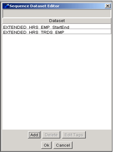

  4. From the Scenario menu of the Sequence Scenario Editor, select Dataset.
    The Sequence Dataset Editor dialog box displays.
    Figure 6-5 Sequence Dataset Editor Dialog Box
    This dialog box lists the datasets that compose the current sort. You can filter the list of datasets to include:
    • Wrapper datasets only (all wrapper datasets are realized)
    • Wrapper datasets and any realized, derived datasets
    • All datasets (wrapper and derived)
  5. Click Add in the dialog box to view available datasets.
  6. Click the dataset you want to add to your sort.
  7. Click Ok.
    The selected dataset name displays in the Sequence Dataset Editor dialog box.
