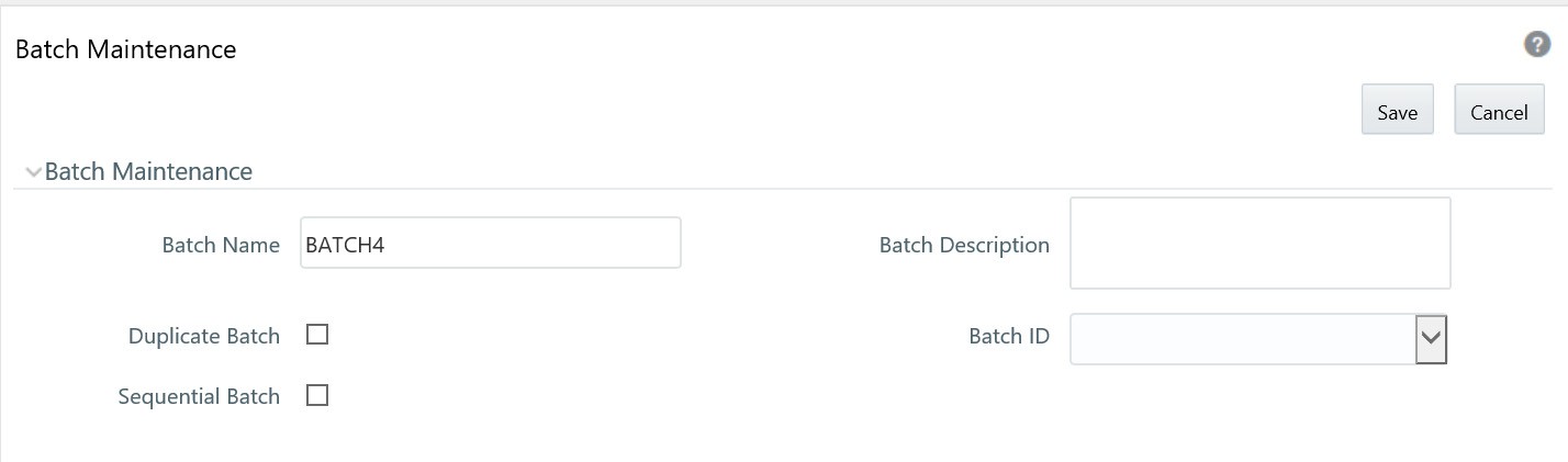

  4. In the Batch Name section, click Add. The Add Batch Definition page is displayed.
    Figure 5-2 Add Batch Definition page
  5. Enter the batch details as described in the following table:
    Table 5-6 New Batch Details
    Field Description
    Batch Name Enter the name for the new batch.
    Batch Description Enter a description for this batch.
    Duplicate Batch Select this check box if the batch is a duplicate batch.
    Sequential Batch Select this check box if the batch must be run sequentially to another batch
    Batch ID The Batch ID will be auto-populated.
  6. Click Save. The added batch appears in the Batch Name section of the Batch Maintenance page.
